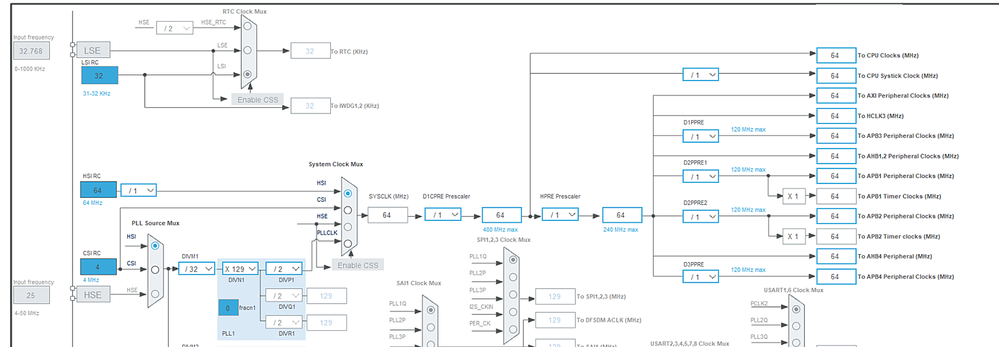

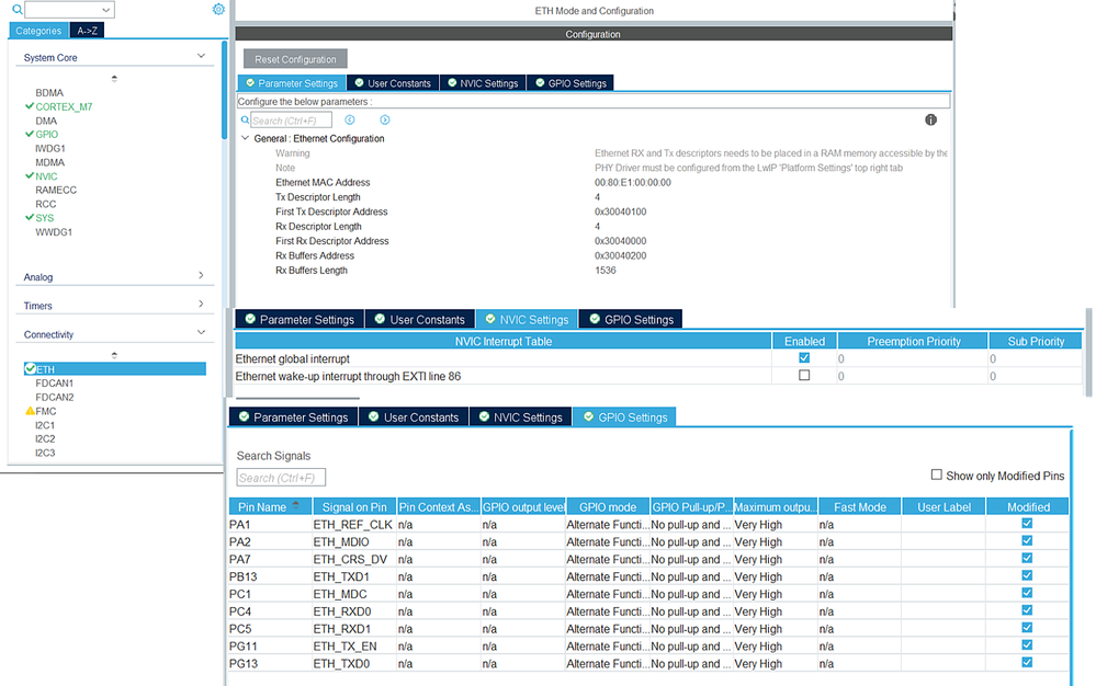

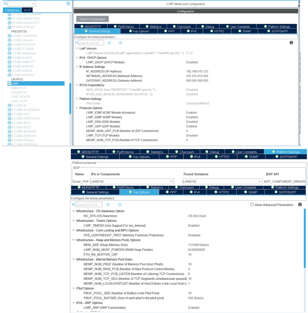

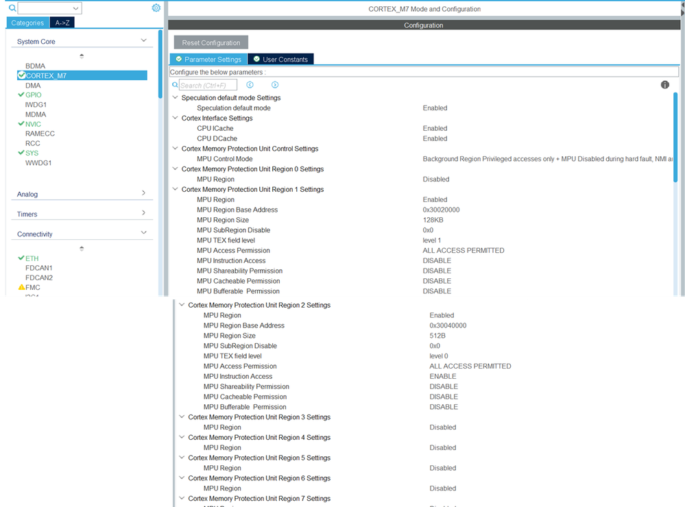

"Let me share my CubeMX configuration with you first so we can review the setup."
1. System Core - CORTEX_M7
2. Connectivity - ETH
3. LwIP
4. Clock

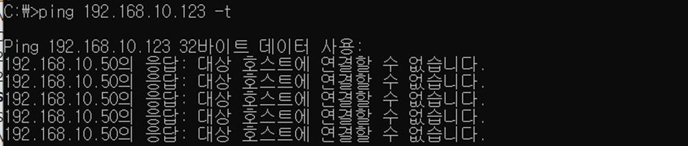

The results are shown below.
Pinging 192.168.10.123 with 32 bytes of data:
Reply from 192.168.10.50: Destination host unreachable.
I am receiving these messages as shown in the screenshot,
and I'm reached out because I’m not sure what I might be missing in the configuration.
As you can see, I am getting 'Destination host unreachable' errors.
I would appreciate it if you could help me identify what's wrong.

Please assign proper Gateway address.
Also check the Network setting in your laptop. "Lwip_init();" seems to be missing.

I would like to share the specific modifications I made to my code to get a partial response:
  1. MPU Configuration: In the void MPU_Config(void) function, I commented out the following lines:
    • MPU_InitStruct.Number = MPU_REGION_NUMBER0;
    • MPU_InitStruct.Number = MPU_REGION_NUMBER1;
  2. Ethernetif.c: In the low_level_output function, I added the following line: SCB_CleanDCache_by_Addr((uint32_t *)((uint32_t)p->payload & ~0x1F), p->tot_len + 32);
With these changes, Ping works correctly.
However, I am aware that simply commenting out the MPU configuration is not the proper solution. I want to identify the root cause of the issue. I have consulted AI tools like ChatGPT and Gemini, which suggested adjusting the MPU regions and linker scripts, but even after applying those suggested changes, the system still fails to work correctly (it often goes into a HardFault or fails to initialize).
What could be the problem here? Any insights would be greatly appreciated.

I have retested the example I attached, and it works whether FreeRTOS/DHCP is enabled or not (with minor adjustments). To transform it into a standalone application with a static IP, I made the following changes:
  1. Opened MX2 configuration.
  2. Disabled FreeRTOS.
  3. Inside the LwIP configuration tab, disabled DHCP.
  4. Set the IP Address and Netmask.
  5. Generated the project.
  6. Inside the while loop, called MX_LWIP_Process().
  7. Built and ran the project.
The only misconfiguration I found is that the allocated LwIP heap memory (16KB) is less than the one allocated and protected by the MPU (128KB), and the Rx buffer count is set to 10 instead of 12. Nonetheless, this does not affect the functionality of the project for an application that only handles pings. I suggest you re-download the attached project, apply the modifications I mentioned, and test it.

To answer your question, no, it is not mandatory to use a timer as the timebase source instead of SysTick; it is simply a best practice for RTOS applications. In your case, the application should work using SysTick. I have compared both projects ,the one you attached and mine, and I suggest you enable RCC and set HSE to bypass clock source, as timing is crucial for Ethernet. Please try this and get back to me with your feedback.

Thank you for your response.
Currently, on my NUCLEO-H753 board, the external clock (HSE) is set to NC (Not Connected), so I am unable to perform tests using the HSE.
However, I am currently developing another board that uses an external MEMS oscillator, which will allow me to test with the HSE. I will conduct further testing on that board once it's ready and get back to you with the results.
Thank you again for your support.
On the custom board, I used a MEMS oscillator for the external clock and powered it on in Bypass mode.
I found that the ping failed when using SysTick, but it worked successfully after changing the Timebase Source to TIM6.
The exact root cause of this behavior is still unclear.
Hello @KBae.1,
I understand. I have just regenerated the example using SysTick and HSI, tested it successfully, and suggest you try the same approach. Please let me know your feedback after testing.
