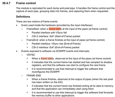

I've made 2 camera drivers so far and the only difference i can see from the cameras is that my first camera module has MIPI short packets start and stop. I'm making this observation from the scope. So i know it's sending the data it's just receiving black messages.
Question
* Do you need short packets frame start and end for it to grab images.
Other info
* I'm using Zephyr, but i just want to make sure from the hardware i don't need short packets because i don't think VD56G3 can generate short packets.

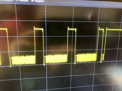

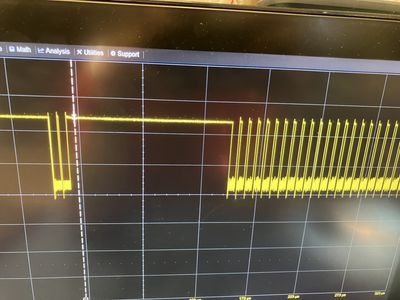

So it does have a frame start. The problem is that i think it's too close to the actual data.
Captured from my driver. Last packet is the short packet
Capture from ST's camera dev board. The far left is the start packet and 2 meta data lines.
So it is sending the frame start packets. So this issue is done
