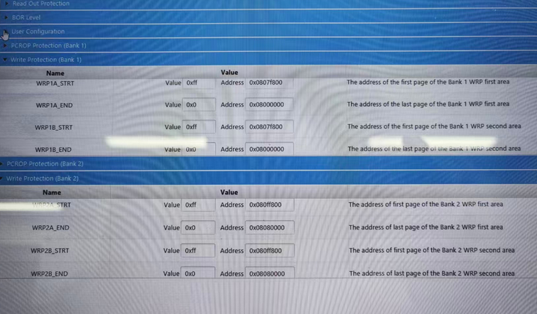

Hello @Saket_Om
Here is the protection area definition read from STM32CubeProgrammer, and it seems address 0x08021800 is not in the protection area.
