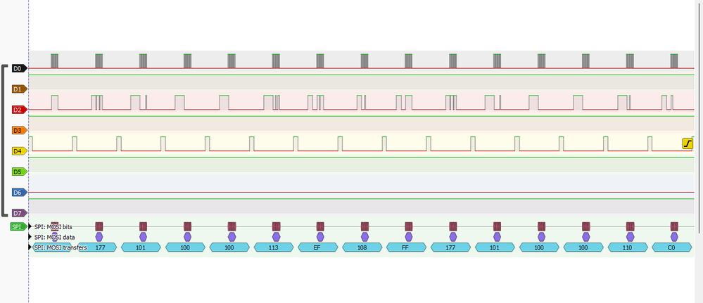

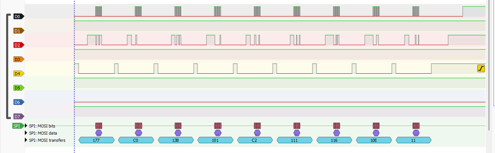

Did you check with the logic analyzer if the first command is really sent or not?
2026-01-29 5:59 AM
Hello @Saket_Om,
Yes, I checked with a logic analyzer.
In fact, the behavior is the following:
The very first SPI frame after reset is not transmitted (it does not appear on the bus).
The following frames are correctly transmitted up to a certain point.
As soon as a HAL_Delay() is executed in the sequence, no more frames are sent after that (the SPI bus remains completely inactive).
This behavior is exactly the same whether the LCD is connected or not, which suggests that the issue is not related to the ST7701S driver itself but rather to the STM32/HAL/ThreadX layer.
On the attached logic analyzer capture, we can see:
the missing first frame,
then valid SPI frames,
then no activity at all after the HAL_Delay().

I attached:
a screenshot from the logic analyzer showing the SPI frames,
and a reduced test code used to reproduce the issue.
This test gives the same behavior:
first SPI frame is missing,
SPI stops after HAL_Delay(),
and the result is identical whether the LCD is connected or no

You're not checking the return values from any of your HAL SPI calls.
Try instrumenting your code (eg, UART output) to see what's happening.
Have you used the debugger to see what's happening in your code?
Examples:
Use the debugger to check if that code is ever actually executed
Use the debugger to see what happens after that HAL_Delay
Perhaps the HAL_Delay is hanging ... ?
2026-01-29 6:35 AM
This is actually an important point:
when I run the code under the debugger, everything works normally.
I can step over HAL_Delay(), and the execution continues correctly after it.
There is no apparent software blocking in the code flow.
However, when running without the debugger, the behavior is different:
and after HAL_Delay() no more SPI activity is observed on the bus.
So the issue seems to be timing-dependent:
the presence of the debugger changes the execution speed and makes the problem disappear.
2026-01-29 6:38 AM
2026-01-29 6:54 AM
