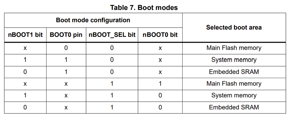

I'm trying to program STM32G030 but I don't have a ST-LINK.
I wonder is it possiable to program this chip through UART interface?
There is a LED-BLINKING program programed by distributer in main flash memory. I have tried to pull BOOT0 to VCC and reset the chip. But the LED on the board is still blinking. I got confused why this chip doesn't go to bootloader but still excute program in main flash memory instead.
If you got any idea about this question, please let me know. Thank you !

Boot0 and Reset may be remapped and set by option bits. Only possible way to attach to such a device in my understanding is:
Get a working G0 nucleo or disco board to try out the procedures and your understanding. Then review the board you have and what is happening with the board.

AN2606 start pattern 11
Boot0(pin) = 0, nBOOT0_SEL(bit) = 0, BOOT_LOCK(bit) = 0 and main Flash memory emptywhen this is default config your MCU start system memory bootloader and you can load first code UART... , but for next starting you need method in your code to jump to system bootloader... read AN
And what is your board have blinky and dont have onboard USB stlink?

If I set nBOOT0_SEL bit to 1, nBOOT0 bit to 1 (boot from main flash memory and BOOT0 pin are not connect to boot mode), and remap SWDIO, SWCLK to reset state (SWD are disabled). I wonder is it possiable to program this chip again?
Thank you.
2022-01-22 6:38 AM
Yes seems your blinky board have WTF setup from line 4.
Then you only can use SWD to get it back or replace chip on board with empty one.
SWD under reset is always work onle RDP level 2 i mean bloack it.
