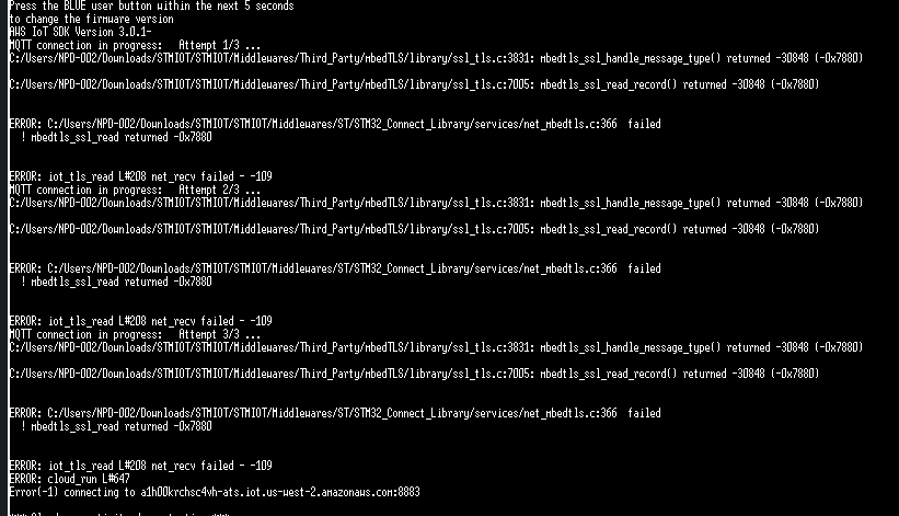

I am using X-CUBE-AWS 1.4 version along with B-L475E-IOT01A board.
I have downloaded the X-CUBE-AWS 1.4 firmware from the below website
https://www.st.com/en/embedded-software/x-cube-aws.html
After building and running the project the following errors occur and do not connect to AWS.
I have downloaded the root CA and device certificate and private key when I created the IoT thing in the AWS.
However, it gives the following error.x509_verify_cert() returned -9984 (-0x2700)
Attaching image for more information
Can someone give me directions who were successful in dealing with this error?

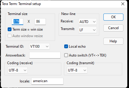

Also:
are you sure you entered correctly the root CA and device certificate and device key ?
when entering the certificates on serial terminal it is important to use carriage return/line feed characters (or just line feed) for end of line.
it is especially important to have CR-LF (or LF) before and after last line "-----END CERTIFICATE-----"
If you use PuTTY serial terminal emulator it sends just Carriage Return (which doesn't work for the application). So try with another serial terminal software (Tera term). Or you must use a special forked version of PuTTY to send LFs.
