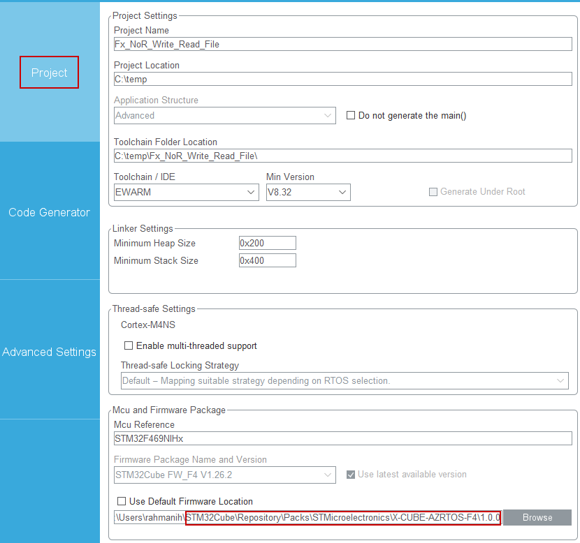

2022-01-20 1:59 AM
Hi @JAgen.1,
under the STM32CubeMX "Project Manager" panel select the "Project" Tab and edit the Firmware location as shown below:
regards
Haithem.

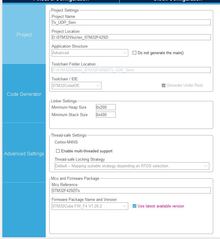

2022-01-23 1:37 PM
Hi Haithem Rahmani,
thank you for your help ! unfortunately i do not get the line you mention (Firmware location) .
Regards,
