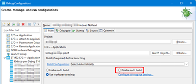

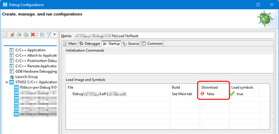

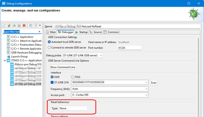

2025-05-14 6:31 AM - edited 2025-12-01 3:19 AM
@MauFanGilaMedical wrote:I tried to run the code without debugger but my processor stuck in some point that I can't see because I have no debugger connected.
Note that you can attach the debugger to an already-running system - so you can see where it is "stuck":
Disable the Reset:
Disable the download:
and you don't want it doing a build:
