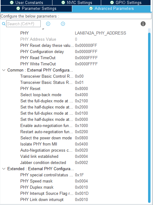

With the help of some analizing tools I found that ETH_TX_EN signal disappears randomly.
Ethernrt controller settings are:
/* Init ETH */
uint8_t MACAddr[6] ;
heth.Instance = ETH;
heth.Init.AutoNegotiation = ETH_AUTONEGOTIATION_ENABLE;
heth.Init.Speed = ETH_SPEED_100M;
heth.Init.DuplexMode = ETH_MODE_FULLDUPLEX;
heth.Init.PhyAddress = LAN8742A_PHY_ADDRESS;
MACAddr[0] = 0x00;
MACAddr[1] = 0x80;
MACAddr[2] = 0xE1;
MACAddr[3] = 0x01;
MACAddr[4] = 0x23;
MACAddr[5] = 0x45;
heth.Init.MACAddr = &MACAddr[0];
heth.Init.RxMode = ETH_RXPOLLING_MODE;
heth.Init.ChecksumMode = ETH_CHECKSUM_BY_SOFTWARE;
heth.Init.MediaInterface = ETH_MEDIA_INTERFACE_RMII;
