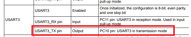

2026-03-16 4:32 AM - edited 2026-03-16 4:46 AM
For SPI this is a regular configuration even with input the push pull mode is set.
For USART1/2 I do agree but for USART3 it's correct:
I will escalate internally for double check. Internal ticket number for follow-up CDM0060571.
