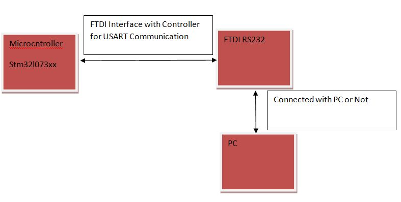

I am working on Stm32l073 series controller. I have small question regarding the deep sleep and exit from deepsleep modes when device is not plugged to PC i must make the device go to sleep. As the Block Diagram I can make it clear. Now my question is that i would like to detect wether my device is connected to pc or not. Using some GPIO pins or an interrupt. If its connected to PC wake up the device from deep sleep or else make the device go to deep sleep mode. I had tried using the pin CBUS 3 on FTDI whenever there is high or low detection indicates connection status. But was unable to achieve. Is there any way how can I detect the status of my device connection using external interrupt or may be any ideas that I can implement through software.

A separate GPIO to VBUS, with pull-down, to function as EXTI ?
Or would the FTDI chip give you any line status information ?

How is a pull-up going to help, you'll see 3.3V vs 5V, both high, so no surprise there.
A weak pull-down, associated with the USB supply on the FTDI, that would be the way to go.
A little potential divider might work even better, and you wouldn't be jamming 5V into the L0 device.
