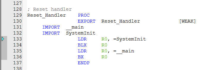

I noticed that when I try to debug the code and place a breakpoint in the main loop that the code does not go directly to the main loop when I press the 'Run' (F5) button in Keil uVision. The 'Run' button instead must be pressed 4 times before it goes to the main loop.
Before the code goes to the main loop, it is caught in the following location in the startup file.

In the startup_stm32f10x_md.s file, the code is getting stuck at the following location:
After I press the 'Run' button 4 times, the code will jump from here to the main loop.

Right now it looks like you have 4 breakpoints set on assembler code, you need to click on those to remove.
Step-Into the line 136 code to see where it goes

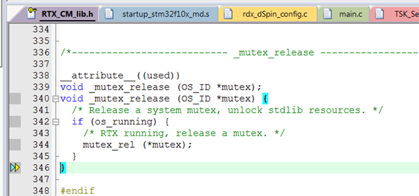

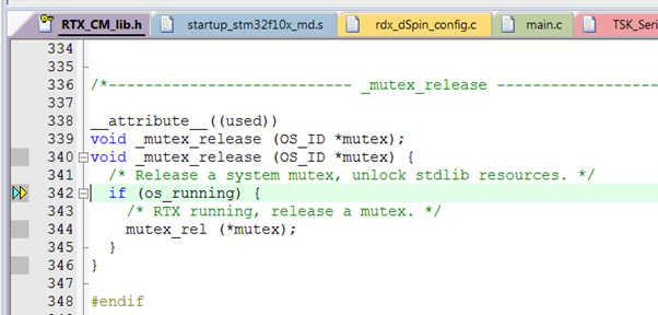

I have removed the breakpoints and when I step into line 136 of the code, I am brought to the _mutex_release function (line 342) in the RTX_CM_lib.h file.
The code then goes to line 346. When I step into the code further, the program hangs.

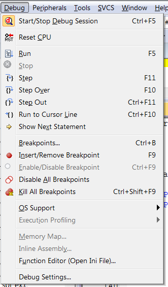

Is this a debug version of the library?
Check the Debug->Breakpoint settings, or if some RTOS level debug/trace options were enabled.

Sorry, I don't quite understand your question.
Which part is the Breakpoint settings?

Is it a 'Debug' or 'Release' build? Could there be a reason it would be breakpointing on the code in question? I didn't create the project, so have minimal insight into the specifics.
Start perhaps with 'Kill All Breakpoints', and see if that alters the fact pattern.
