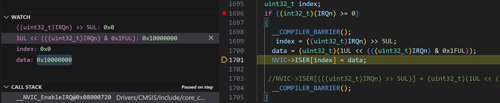

I'm learning to port FreeRTOS to my STM32F407, but I'm running into problems with HAL initializing TIM2.
After HAL_OK the program is supposed to enable TIM2IRQ via NVIC_EnableIRQ(), but the operation of writing to NVIC->ISER doesn't seem to work.
NVIC->ISER[(((uint32_t)IRQn) >> 5UL)] = (uint32_t)(1UL << (((uint32_t)IRQn) & 0x1FUL));So I followed this post and modified 'CMSIS\Include\core_cm4.h', but again it didn't work.
uint32_t data;
uint32_t index;
if ((int32_t)(IRQn) >= 0)
__COMPILER_BARRIER();
index = ((uint32_t)IRQn) >> 5UL;
data = (uint32_t)(1UL << (((uint32_t)IRQn) & 0x1FUL));
NVIC->ISER[index] = data;
}My debugger won't continue after this expression, any ideas?

@Jemegen Please, show the actual code. What means "after HAL_OK"?
2024-04-14 6:26 PM
HAL_OK is the return value of HAL_TIM_Base_Init() in HAL_InitTick()

HAL_NVIC_EnableIRQ(TIM2_IRQn) calls NVIC_EnableIRQ(), which is __NVIC_EnableIRQ()
Drivers\STM32F4xx_HAL_Driver\Src\stm32f4xx_hal_cortex.c:
void HAL_NVIC_EnableIRQ(IRQn_Type IRQn)
/* Check the parameters */
assert_param(IS_NVIC_DEVICE_IRQ(IRQn));
/* Enable interrupt */
//NVIC_SetVector(TIM2_IRQn, TIM2_BASE);
NVIC_EnableIRQ(IRQn);
These are the code generated by HAL and I don't understand what is wrong. HAL_Init() in main() is the first to perform peripheral initialization.
