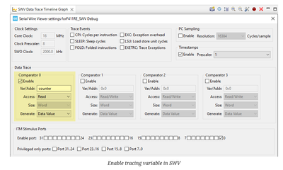

2024-04-14 12:57 AM
If you have SWO connected, you could try with SWD to catch the writing to the variable address of interest :
https://www.codeinsideout.com/blog/stm32/swv/#inspect-variables
