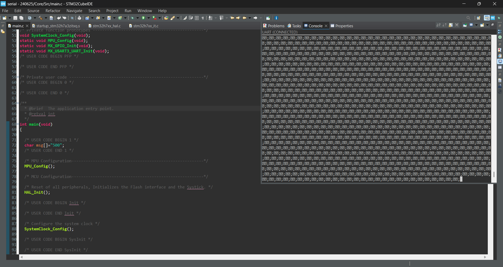

I assigned pD8 and pD9 as usart3_TX and usart3_RX in the GUI and soldered pins on the board's pD8 and pD9 pins.
I got signal from PD8 and also got some characters printed in my serial monitor in the CUBEIDE but they aren't the desired characters.

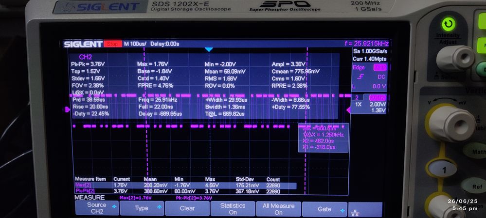

Please see your scope manual for how to properly capture screenshots - this will give much better results than photographing the screen!
It looks like it should be able to do serial data decoding:
You shouldn't need to solder anything - this should be the default.
"Garbage" characters like that generally mean you have the baud rate wrong:

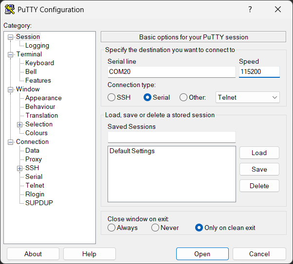

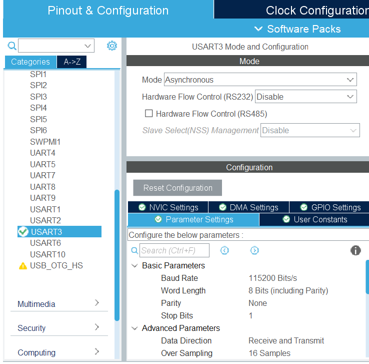

Sorry for asking again . But the baudrate of USART3 and putty seems to be the same 115200 and still getting the garbage characters
the usart3 set to 115200
putty serial set to 115200

Use the scope to measure the actual baud rate.
Continuously transmitting uppercase 'U' is good for this ...
2025-06-26 10:13 PM
I tried giving uppercase 'U' but in every baudrate my signal on the oscilloscope remains the same and it doesn't seem to be of '010101'.
At 57600 baudrate I got uppercase 'L' and at 80,000 baudrate I got uppercase 'G'.Is there a specific way to find the baudrate other than trial and error?
2025-06-30 8:23 AM
@KRISH_ wrote:I tried giving uppercase 'U' but in every baudrate my signal on the oscilloscope remains the same and it doesn't seem to be of '010101'.
Remember that the oscilloscope trace will also show start & stop bits ...
