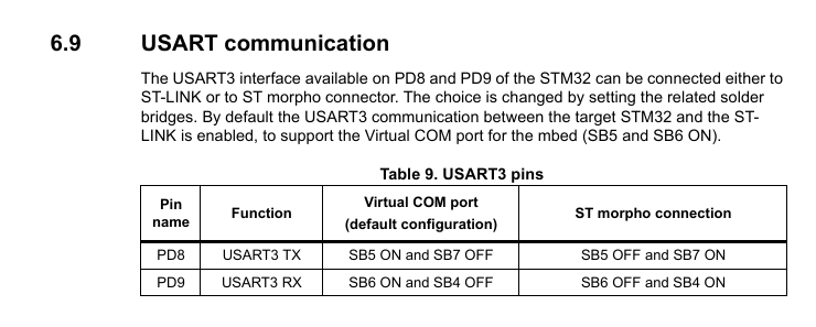

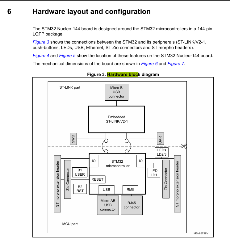

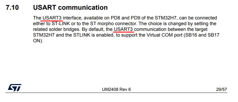

@KRISH_ If you're expecting to use the Virtual COM Port (VCP) in the ST-Link, that is connected to USART3 - not USART2:
via: https://www.st.com/en/evaluation-tools/nucleo-h7a3zi-q.html#documentation

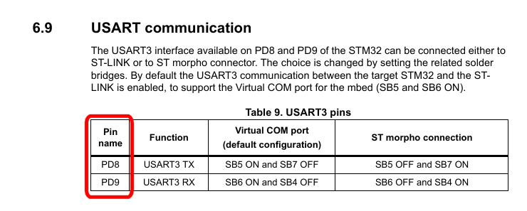

I checked the User manual, it said USART3 .But still I wasn't able to enter anything in the serial console.

So you are trying to go via the ST-Link's VCP, then?
Were you misled by the tutorial into using UART2?

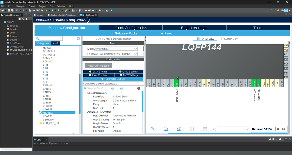

Using Putty (serial connection), i am testing whether I can enter characters to the terminal. I believe the characters I enter should be visible to me. It is not just about HAL_UART_Receive, I can't see the transmitted data either with sprintf().
The pins shown in the user manual are PD8 and PD9, but by default, the assigned pins are PB10 and PB11.In the NVIC settings I have enabled USART3 as global interrupt.
I have chosen the correct COM port, which is COM20 (I double checked using the device manager). I do not know whether the data I am sending via USART is reaching the MCU. But the printf() statements do get displayed on the serial monitor.

The VCP is connected to pins PD8 (UART TX output) and PD9 (UART RX input):
You won't get anything through the VCP unless you use those pins!
