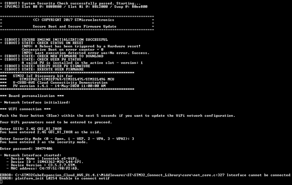

I'm trying to run the Getting Started firmware for the B-L475E-IOT01A board but I'm having problems to connect to WiFi. The error messages are:
"ERROR: C:\STM32CubeExpansion_Cloud_AWS_V1.4.1\Middlewares\ST\STM32_Connect_Library\core\net_core.c:327 Interface cannot be connected
ERROR: platform_init L#254 Unable to connect netif"

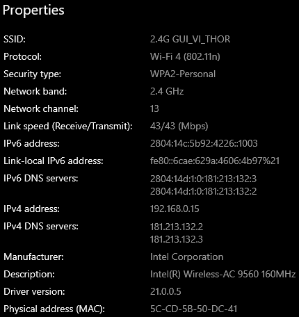

These are my WiFi Properties:
OBS:
Am I missing something?

Hello @gvamorim and welcome to the Community :)
Did you try the WiFi project for B-L475E-IOT01A board available within STM32CubeL4 MCU package?

Hi @Guillaume K and @Imen DAHMEN ,
I'm now able to connect to the WiFi access point. It seems that the WiFi should be configured with access point and I was not aware of that.
