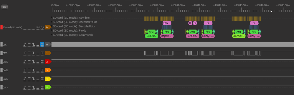

With the Logic Analyzer i am observing the communication.
Card Init:
Requesting Card Type, CSD and CID works well over the CLK and CMD Line.

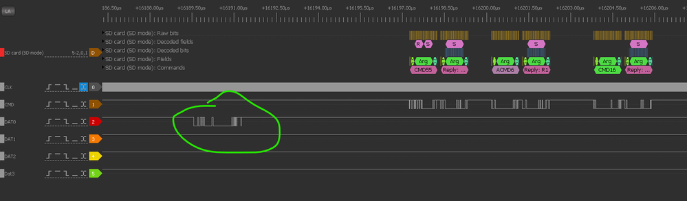

While Switching to the 4Bit Mode i'm getting wrong feedback via the Data line. In detail there is a problem with the FindSCR function still in 1Bit Mode. SDMMC_CmdSendSCR is send out correctly. The DPSM is reacting correct to the Data0 lines response. Flags a set correct for 2 32Bit words but SDIO_ReadFIFO() will only give zero as feedback.
Log Sending SCR:
Response:

All Data[0:3] and CMD line have 10k Pullups and a serial resistance of 33Ohm. On the logic analyzer signals a OK to the pins of the MCU. In my opinion is look like some "internal" stuff.
