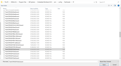

You can find .board files under this path "..\Program Files\IAR Systems\Embedded Workbench 9.0\arm\config\flashloader\ST "
