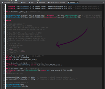

1. I modified the flash script and placed the user code in ethernetif.c same as it's been done in the example.
2. The MPU is configured the same as it's in the example.

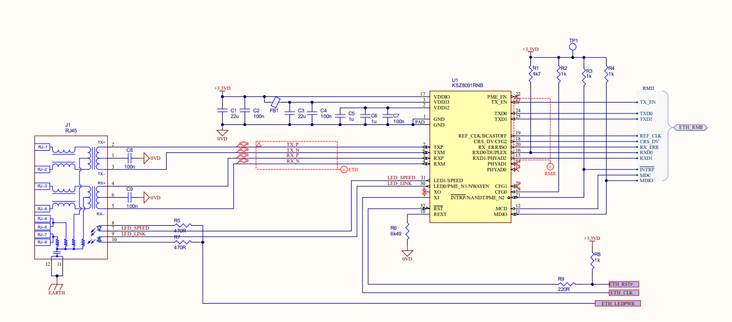

However, there is a slight difference in the hardware. I'm using KSZ8091RNB - Also uses RMII same LAN8726 PHY. So should be swappable with the one in Nucleo Board.
ps : The board is modified to have a steady 25 Mhz clock to the ethernet driver. So, generating a clock from MCU does not matter.
