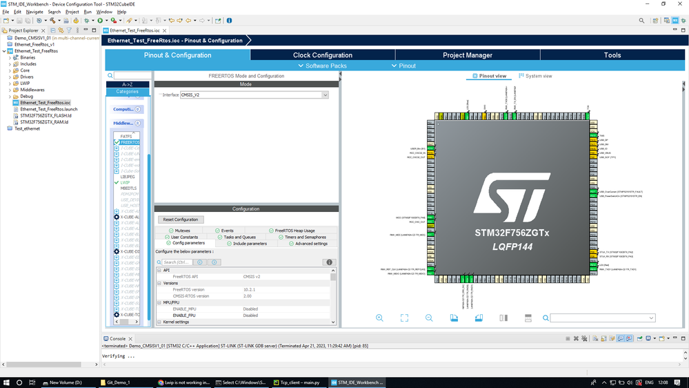

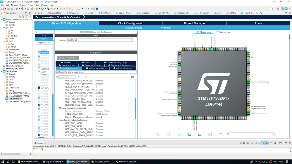

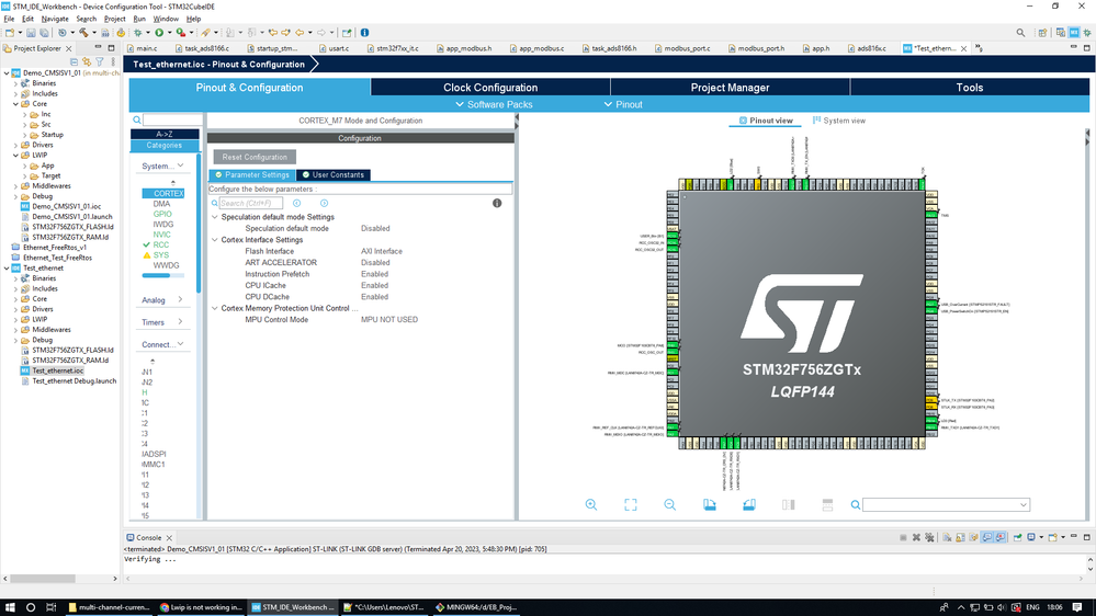

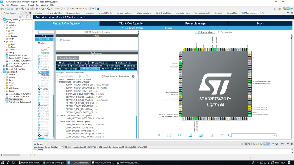

I am using STM32CUBEIDE 1.12.0.

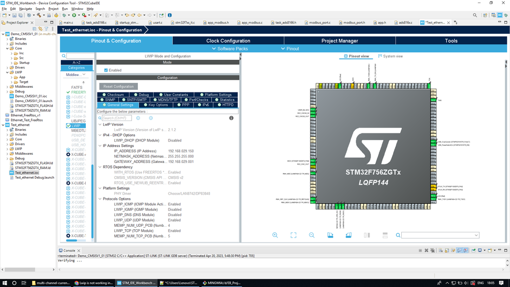

Scenario: I want to create a TCP server with FREERTOS CMSISV2.
Steps that i follow,

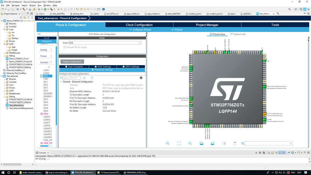

Step 1: configure ethernet.

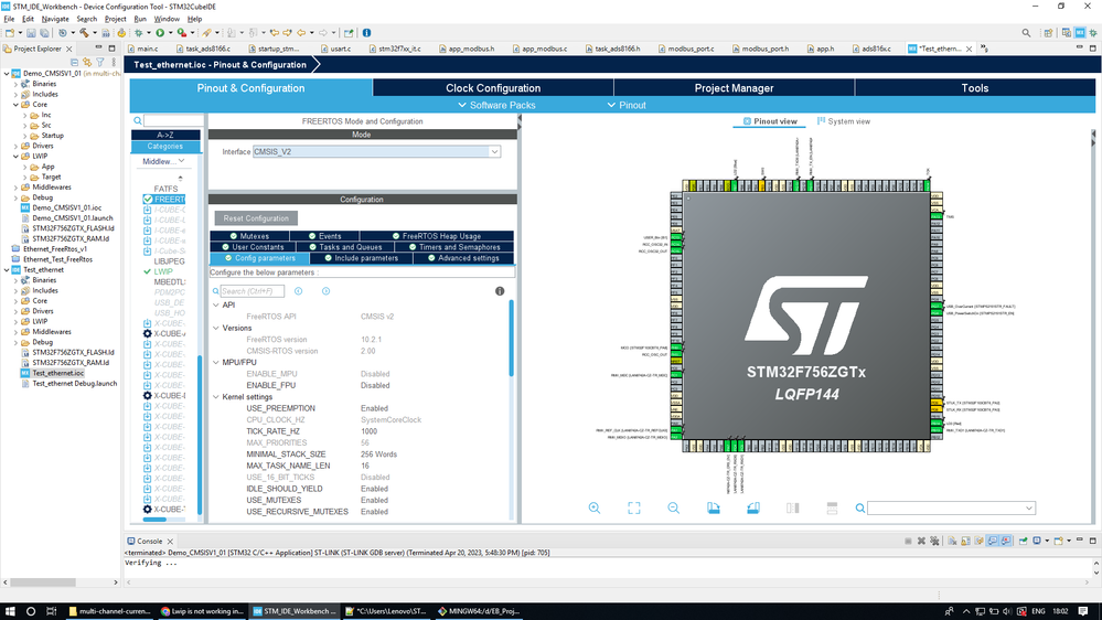

Step 2: freertos configuration

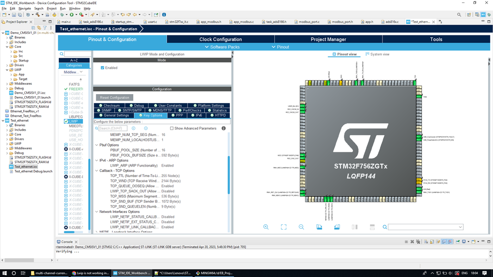

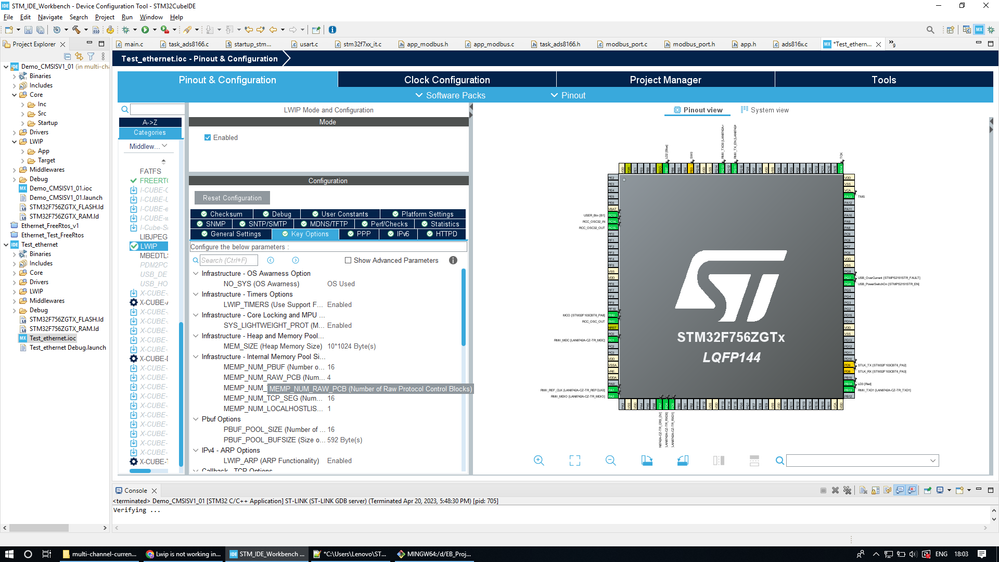

Step 3: LWIP configuration.
Step 4:coretex m7 configuration.

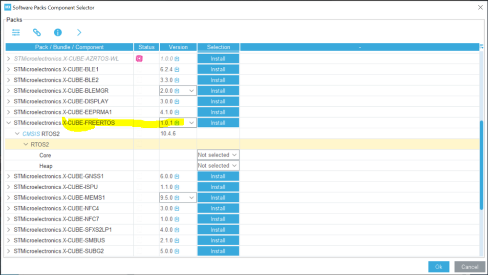

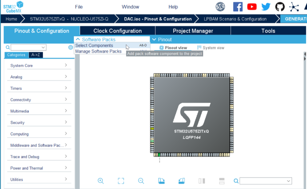

I would able to find a version of STM32CubeMX which is V6.8. But I would not able to find a version of x-cube-freertos. Can you please help me to find it?

You can check the pack version in the "Software Packs"
2023-04-24 8:42 PM
Thanks @Imen DAHMEN ,
I checked x-cube-freertos version which is v1.0.1.Although it is not working.
