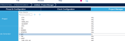

You can switch between HAL and LL drivers (when available) in the Project Manager TAB (Advanced Settings).
This should enable USE_FULL_LL_DRIVER automatically.

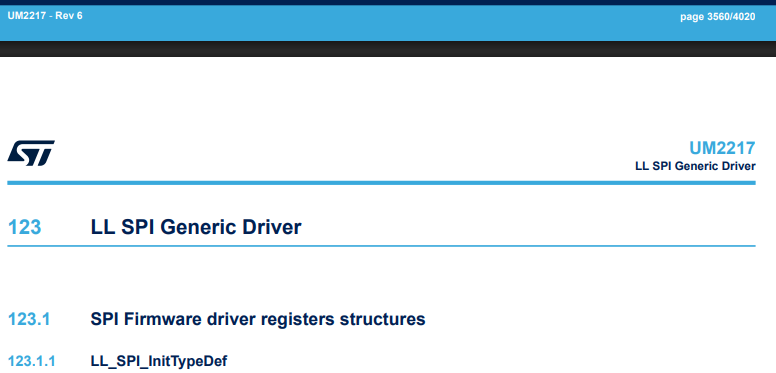

The document you require is UM2217, Description of STM32H7 HAL and low-layer drivers:

- You can also use STM32CubeMx tool and ensure that the desired SPI peripheral is properly configured in STM32CubeMX before generating the code. Verify that the LL drivers are enabled in the STM32CubeMX configuration (Project Manager > Advanced Settings).
For that, you can refer to these sections: "4.11.3 Advanced Settings tab" and "6.2 STM32Cube code generation using Low Layer drivers", in the UM1718: STM32CubeMX for STM32 configuration and initialization C code generation - User manual
