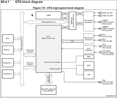

Hello @MADHU2
After double-checking, the STM32F7 USB_HS and USB_FS do not share the same PHY hardware. I was initially confused by the STM32MP1, which does share access to the PHY.
I apologize for any confusion caused.
The issue appears to be more related to FatFs rather than USB. Currently, I need to confirm whether FatFS can handle double instance registration. I will get back to you as soon as I have useful information that can help resolve the issue.
