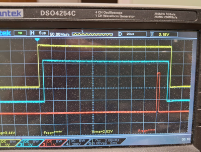

2024-09-02 1:49 PM
Thanks JW.
Eventually I got that to work, sort of:
I had to use two timers. I couldn't get it to work with TIM1 CH5 as suggested, so the yellow and blue traces are on TIM1 and the red trace is on TIM2.
I had to fudge the timing on TIM2 because the pulse was ~ 5us delayed. I would prefer not to do that so need to figure out how to sync the timers.
paul
