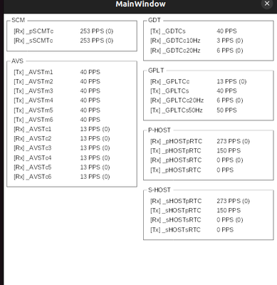

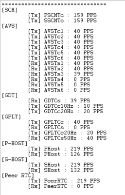

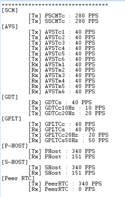

In STM32Cube FW_H7 version 1.11.1, UDP performance was normal, but in version 1.11.2, it fails to handle all transmitted and received packets. (STM32CubeMX Version 6.12.0)
Except for the STM32Cube H7 firmware version, all configurations and source code are identical.
- In STM32Cube FW_H7 version 1.11.1.
- In STM32Cube FW_H7 version 1.11.2.

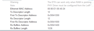

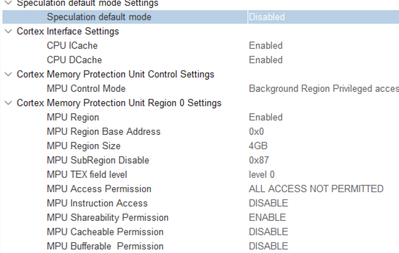

The configuration (without RTOS) of my project is below.

Hello @SungjunLee ,
I tried with both version of cube Firmware with you test but I get the same result as the second screenshot you shared booth firmwares are around 135 as an average .
I don't know exactly how this is calculated as i only have the executable but i would recommend you turning some known test version such as Iperf LWIP also make sure to check this fix related to the Ethernet driver and insure if it is applied on your firmware version.

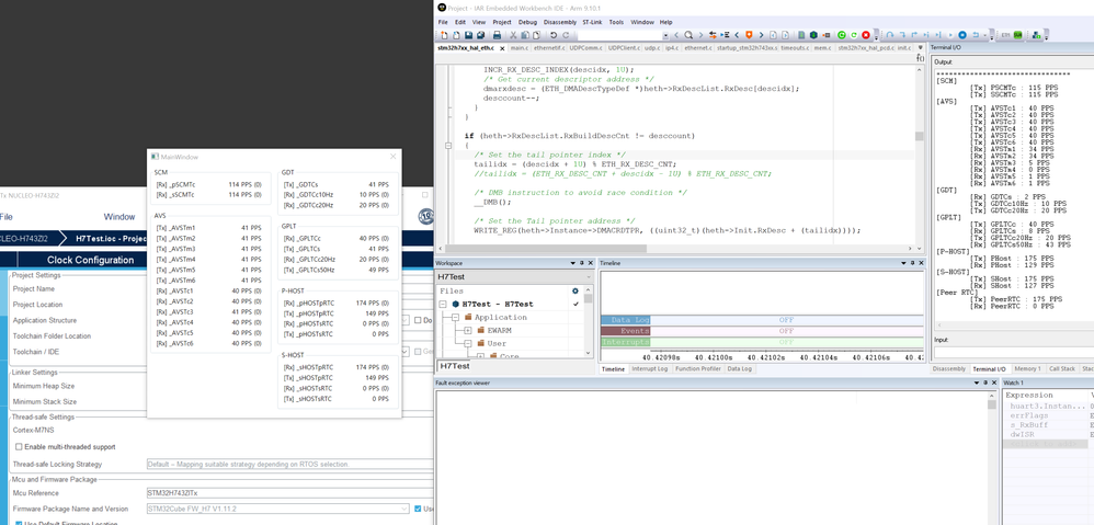

update :
when changing the line 1212 of stm32h7xx_hal_eth.c as proposed by the github fixe i get better and stable performance :
/* Set the tail pointer index */
//tailidx = (descidx + 1U) % ETH_RX_DESC_CNT;
tailidx = (ETH_RX_DESC_CNT + descidx - 1U) % ETH_RX_DESC_CNT;

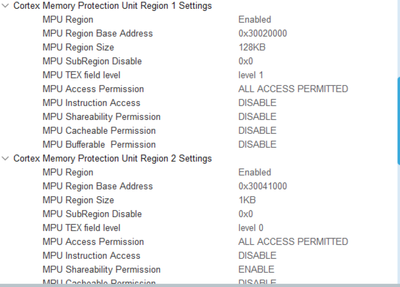

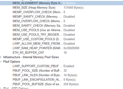

2024-08-28 6:31 PM
Hello @STea .
Thank you for your reply.
I use one project and IDE I use is EWARM .
I just tested by changing H7 FW version from 1.11.1 to 1.11.2 and vice versa.
I share the linker file, the generated ethernetif.c file, and IOC file.
The generated linker files and ethernetif.c files are completely the same regardless of the FW version.

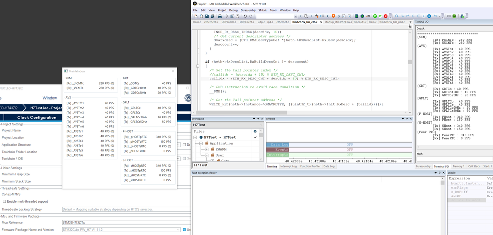

2024-09-02 4:44 AM - edited 2024-09-02 5:02 AM
Hello @SungjunLee ,
update :
Regards
2024-09-02 4:55 PM - edited 2024-09-02 6:38 PM
Hello @STea .
Thank you for your answer.
I modified the part (line 1212 of stm32h7xx_hal_eth.c) as you suggested, tested and compared.
I got desired performance.
Thank you again for your help.
However, It is really annoying to have to modify it every time I generate code with STM32CubeMX.
Of course, it is also possible to modify the driver itself in the repository, but I want to keep the original FW versions as is.
I hope they fix that in the next update.
