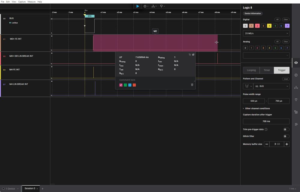

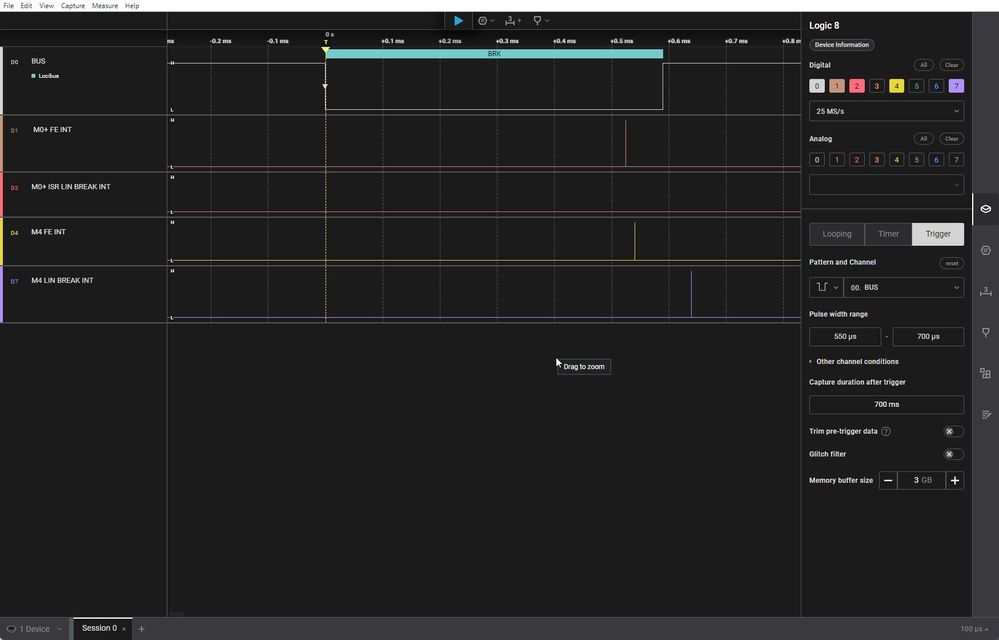

The calls to debug_io_iface() just generate some narrow pulses on spare GPIO pins which we look at with the analyser to check timing. We generate a "break" pulse of about 600us (baud rate is 19200) every 100ms This is what we see for the Cortex M4 chip. As expected we see the Framing Int during the break, it is discarded, then the BREAK int is raised just after the rising edge of BREAK as expected.
Here is the zoomed out image showing the interrupts of rthe M0+ chip. We get the FE at pretty much the same time as for the M4, but the BREAK interrupt does not happen for another 7ms ! Much later than expected.
What is going on?
