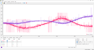

I have an STM32G431 doing FOC on a little gimbal motor, but am getting strange noise on the current sense ADC when it's being triggered by TIM3. It shows up as random spikes, which values always end up being dividable by 8.
Weird thing is, if I have the ADC set to oversample, it will average out these spikes. While I'm 100% sure it's a digital artifact, not measured noise. That would never ever all end up with the last 3 bits being "000".
Here's a direct comparison by the ADC being triggered by TIM3's TRGO directly:

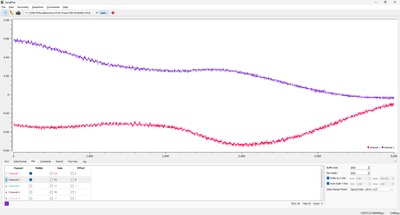

And changing nothing but starting the ADC through software in the TIM3 update event interrupt:

I had a look at VREF+ (and VDDA) on the scope, and they look quite solid. Measuring vrefint with ADC1 also only gives me a couple counts of noise. It's only ADC2 that has the issue, and only when triggered by the timer directly. While the VREF+ issue sounds relevant, I'm not sure how it would apply here. What do you think?

While you haven't provided absolute scale, you appear to talk about 3 bits of noise, i.e. around 5mV. These may also be very short pulses. Ground arrangement during measurement matters, too.
