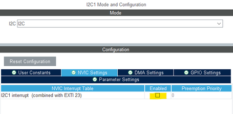

2025-06-06 3:39 PM
Did you enable the NVIC?

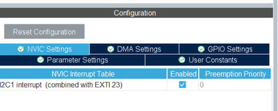

2025-06-09 6:38 AM
Yes, on the slave side (STM32C0 Nucleo Board) where I use interrupts, I have enabled the NVIC.

Hello @HPate.12
Please refer to the example below:
