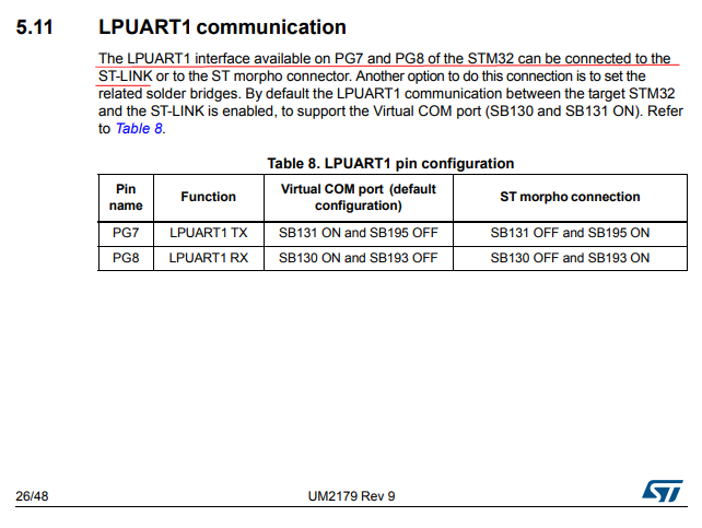

2024-11-20 3:32 AM
@RiccardoMilici wrote:3. In Pinout & Configuration I go to Connectivity -> USART2 -> Mode Asynchronous and leave the default values.
User manual says it's LPUART1 connected to the VCP:

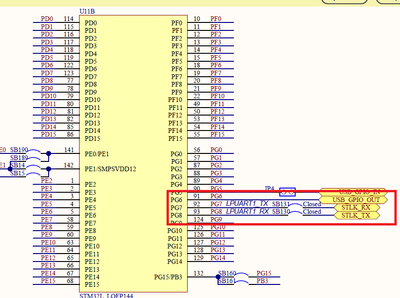

2024-11-20 3:53 AM - edited 2024-11-20 3:54 AM
Simply because USART2 is not connected to STLINK virtual comport on NUCLEO-L496ZG-P board.
Based on the board schematics, you need to use LPUART1 instead:

2024-11-20 4:16 AM - edited 2024-11-20 10:46 PM
You are right, I didn't pay attention on the used board.
Thank you @Andrew Neil for pointing out to me.
