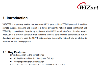

@SGasp.1 wrote:The wiznet has been programmed with the following fw .
https://docs.wiznet.io/Product/S2E-Module/WIZ750SR/download
So the Serial-to-Ethernet firmware?

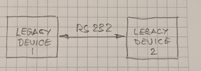

It's for converting a "legacy" situation like this:
to this:
So the "legacy" devices remain blissfully unaware that they are not actually connected directly by the RS232!

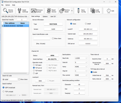

It is clear that the setting of the uart for both chips must be the same..
For stm32 it is easy i have cube ide and for the wiznet i have the following amazing tool
Once this step is done i have to communicate -- correct ?
