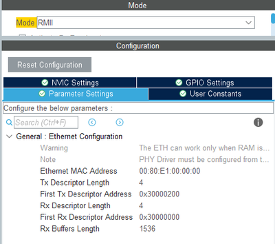

Here are the configurations of our system:
Not using RTOS, using lwIP.
Using external crystal 25mhz, not same as Eval board that from STlink, so RCC select HSE Crystal/Ceramic Resonator instead of BYPASS clock source.
CPU set as 550mhz.
MPU setting: flash.ld

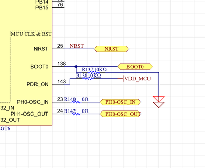

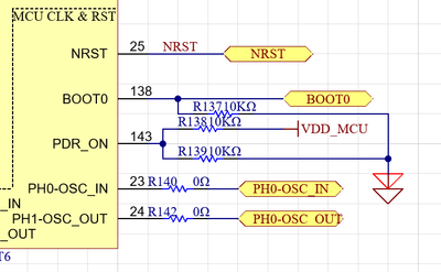

Here are two changes made in the hardware:
one was PDR_ON signal Pin 143 had two resistors R138 10k to VDD and R139 10k to ground. Change made to remove R139 to ground.
Before
After

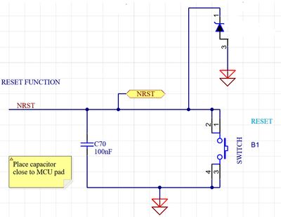

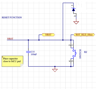

2nd change was to add the delay to the RST pin to keep it stay grounded for 68ms upon power up.
Before change:
After change

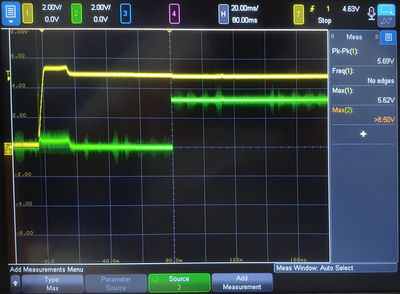

Hi @STea ,
1. Here is the scope shot of RST:
On the scope ch1 shows the 5v signal with no delay. Ch2 shows the 3.3v signal which is delayed and used to hold the NRST pin Low for that time. (~68ms theoretical, measured ~80ms).

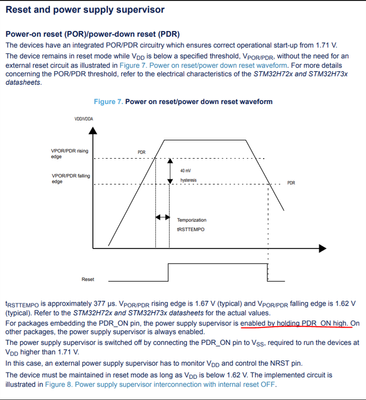

2. Hardware designer found it from this ST application note:
For packages embedding the PDR_ON pin, the power supply supervisor is enabled by holding PDR_ON high. Thus, the resistor connecting PDR_ON to ground was removed.
Thanks
