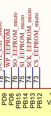

Hi community, just a single question as confirm.
I am working with stm32f429.
From the schematic the hw engineer decided to use the following pin for spi purpose for communicating with an eeprom
Can you confirm that i cannot use those pins for spi purpose ?
(i have tried to select sp1,sp2,sp3,sp4,sp5,sp6)
Thanks a lot

F429 - case ?
from ds , p.62: PB13 , should be sck_eeprom - right ?
-> spi2_sck is possible, so check , for other pins for your eeprom on SPI2 ;
pin74 --> LQFP144 .
When in Cube select/activate spi2 , then can choose also alternative pins for some peripherals ;
you can select them manually, click on the pin and choose..
2024-01-11 1:34 AM
Hi @AScha.3 ,
thanks for the quick reply
case is stm32f429zit6,
what do you mean for spi2_sck is possible, so check , for other pins for your eeprom on SPI2 ;?
the point is is all the pins are ok for spi and how to change the proposed pins in cube mx
Thanks

>mosi and miso are inverted
signal inverted ? pins exchanged ?

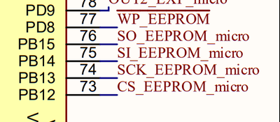

2024-01-11 2:49 AM - edited 2024-01-11 2:50 AM
@AScha.3 - "pins exchanged ?"
Look at the diagrams:
This is why names like "SI" and "SO" are best avoided: they are ambiguous - does your "SO" mean output from the MCU to the EEPROM, or output from the EEPROM to the MCU?
Using MISO and MOSI* removes this ambiguity!
* or modern alternatives alternatives like PICO and POCI: https://www.sparkfun.com/spi_signal_names

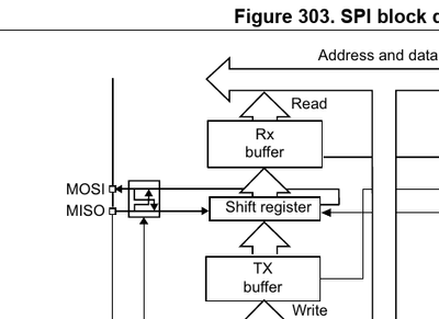

1. I have no eeprom connected... ( this i made just to show you, how to do)
2. right or wrong : which eeprom and connected pins ?
3. Maybe your lucky : miso--mosi can be swapped on some cpu , just look in your rm -> spi.
here from f44x manual:
