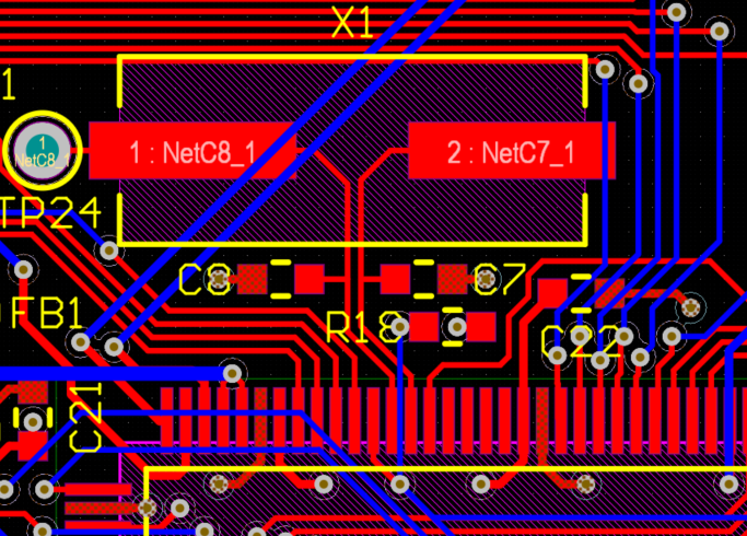

We have been experiencing dropped bytes during UART communications and have determined the root cause to be an unstable external oscillator.
The external oscillator placement does not follow the recommended guidelines and is resulting in the PLL desynchronization, which in turns leads to a 10-20us transient on the main clock. If this transient occurs while we are reading or writing UART data we will get 'NF' and 'FE' noise/framing errors on the UART bus register and subsequently lose information.
This image shows our bad oscillator placement/design

2022-01-06 9:58 AM
The most important document for a successful oscillator design is the AN2867. There are also some PCB layout recommendations and hints in section 7.2, which may help with troubleshooting.
First of all: it seems to me that you have used a normal GND plane for the load capacitances. In such a case, it is not surprising that removing the capacitors will alleviate the problem somewhat for the time being.
Important is indeed the complete decoupling of the crystal and the capacitors incl. (!) the GND connections, as shown in fig. 14 of AN2867.

2022-01-06 3:08 PM
Your design does not look optimal, but sensible. With a normal crystal and about the right load capacitance, the design should work. Are you sure there is no other major disturbance going on, e.g. external EMC, switching of haevy load, unstable supply. Look at those issues too.

Interesting about the decoupled GND, is the STM's crystal input stage THAT sensitive?
I have been designing with all kinds of frequencies for all kinds of MCUs for years, always using connections from the crystal caps to the GND plane(s), never had any trouble with that.
With connections as short as possible and no high frequencies on the signals close to the crystal - MCU connections.
For the design above:

Thanks for the tips. I agree that the grounding likely has something to do with this problem.

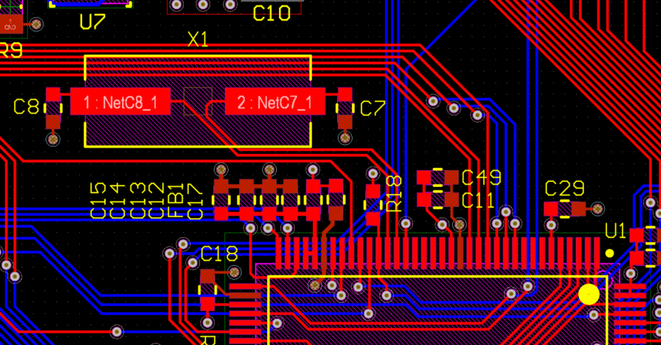

There's a can of worms behind this question. I spent many days trying to figure out why these clocks are unstable and have come up with no other explanation. For reference we have an identical board to this one where the crystal is in a much better position
These boards rarely show the issue, but still occasionally have the clock transient, which does lead me to think there is something else going on with these boards.
Power supply is stable during transient. External EMI is unlikely because these boards have the issue even when set on a bench away from other equipment. Not sure if the FMC_A# RAM traces nearby could cause something since they are practically touching the xtal....
We have given up on the external xtal for now and are switching to the internal until we can get the time to redesign the board. We are just trying to be sure that we don't run into any unexpected problems by using a clock that is less accurate.
2022-01-10 7:04 AM
If the blue tracks running diagonally across the crystal transmit switching edges and there is no GND or VDD layer between these tracks and the crystal, you will not get a stable clock at the LSE. The LSE input is extremely high impedance and sensitive, so it makes a lot of sense to follow the above recommendations, plus route switching signals in a wide arc around the LSE.
