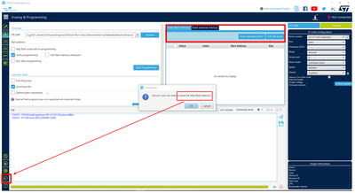

Hello @dip ,
You can erase the memory of your STM32F407G-DISC1 using some tools provided by ST.
CubeProgrammer, a tool provided by STMicroelectronics, allows you to manage this task efficiently.
Here is a step-by-step guide to erasing the memory of a microcontroller using CubeProgrammer:
Step 1: Installing CubeProgrammer
Step 2: Launching CubeProgramme
Step 3: Connecting to the Microcontroller
Step 4: Erasing the Memory

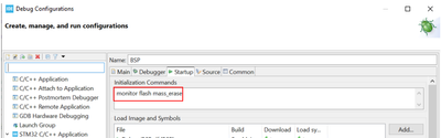

CubeIDE, an integrated development environment provided by STMicroelectronics, also allows you to erase the memory of a microcontroller.
You can go to the startup tab in the “debug configuration” and add "monitor flash mass_erase" as an Initialization command.
