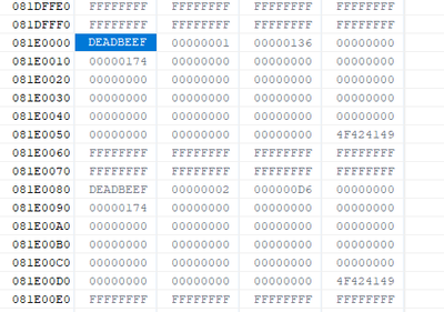

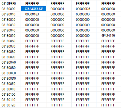

I am working on a H755zi-Q Nucleo board , I am using the flash memory to store some parameters and i have implemented flash wearing as well, All this works fine , my data persists across resets and is correctly loaded upon reset, and i have even verified this in the memory , in debug mode i see each page being written perfectly on every write command, when i upload a new code or sometimes when i terminate and relaunch the debug session and open memory , i see that data is erased. How do i prevent this?i want to retain that sector's data over flashes and debug sessions, the memory sector i am using is far away from my code's sector, (i am using bank 2 last sector).
This is my initial data in the memory, i have entered debug mode, and after performing a new write operation,
here we are again,
but from now if i keep performing write operations they are preserved correctly.

However, I don't think that's the problem here. It looks like your program is doing the erasing, as it is physically impossible to erase less than a flash page. Also, the "erased" screenshot you have above shows some portions of the page have been written.
I suggest looking for bugs in the code logic. Log messages to UART or some other readable output when erases and writes are done.
