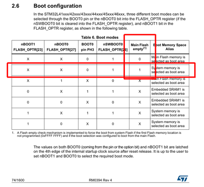

Always post which STM32 model are you using (RM0394 partially gives it away, but for example the following text does not apply to the "mid-range" 'L4).
@Tesla DeLorean refers to the infamous PEMPTY mechanism.
The exact mechanism with debugger depends heavily on the particular debugger and its exact behaviour.
Try setting the nBOOT0/nSWBOOT0 option bits to 1/0 respectively.

It may be the case at the point of "launch", but the issue is, that the PEMPTY bit is not cleared by any other but power-on reset. Or OBL_LAUNCH; but what any debugger does is often undocumented in the details.
> I don't want to set nSWBOOT0 to 0, because that will cause the BOOT0 value to be taken from the nBOOT0 bit and I'll have the bootloader all the time.
If nBOOT is 1, you won't have the bootloader ever. OTOH, the nSWBOOT0=0&BOOT0=0 combination *does get* overridden by PEMPTY. See the table I've posted above.

JW, the biggest thing I don't get is this: since the PEMPTY condition is latched on power up (not just a reset - is that correct?), why is it that, after power cycling a board that was just programmed, the first debug session I start will end up in the bootloader? (The next relaunch is correct; the one after that goes into the bootloader; etc.)

I was incorrect in an earlier message that setting nSWBOOT0 to 0 would result in the bootloader executing all the time. That would be true if nBOOT0 was set to 0, but mine is not. I verified correct behavior after changing the bit.
