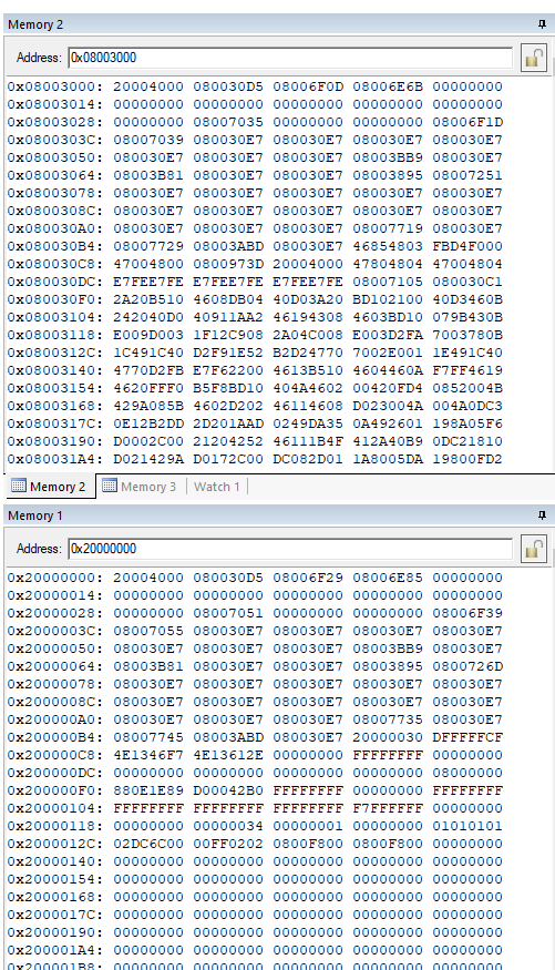

I used memcpy to copy the vector table into RAM. Below shows the results of the memcpy command.
Below is the code I use to copy the vector table and hopefully start to use the new RAM based vector table.

I have been able to verify that my main loop is running, but none of the interrupts are firing. I have also verified that I successfully copied the vector table to RAM (address 0x20000000). I used a scatter file to reserve a memory locations 0x20000000 - 0x200000BF are reserved for the vector table.

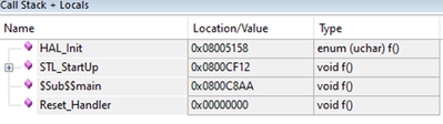

I have narrowed down where the issue is located. We are using a functional safety library. If I run my bootloader application shifted in flash (no functional safety library) everything works properly.
However, when I run my actual code I can see that there are a number of functions called prior to my main() where I relocate the vector table. This was causing the application to crash unless I stepped through most of the process (preventing an interrupt).
I believe this code is causing the problem:
