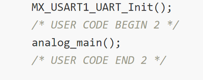

2023-08-31 2:29 PM - edited 2023-08-31 2:31 PM
Okay, here is analog_main() the pedal_intialize() function where DMA is being kicked off, and the DMA function itself. DMA is started by calling:
adc_start(7); // Kick off perpetual ADC sampling
Which is implemented as follows:
#include "driver-adc.h"
extern ADC_HandleTypeDef hadc;
extern void Error_Handler(void);
uint16_t current_adc_vals[12];
void adc_start(uint8_t adc_channels) {
// Kick off next conversion
if(HAL_ADC_Start_DMA( &hadc, (uint32_t *) current_adc_vals, adc_channels ) != HAL_OK) {
Error_Handler();
This code is all completely unchanged from other STM32L152 projects where it works without any problems, but please let me know if this points to anything and if there's any other information I can share to make it easier to diagnose.
