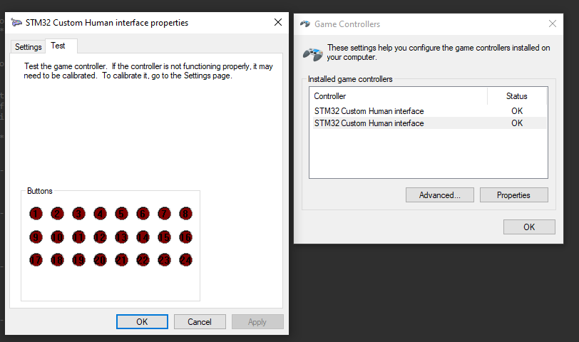

2023-02-14 1:42 AM
Thank You, i have created two game controller but i need different controller name to recognize my pc.
