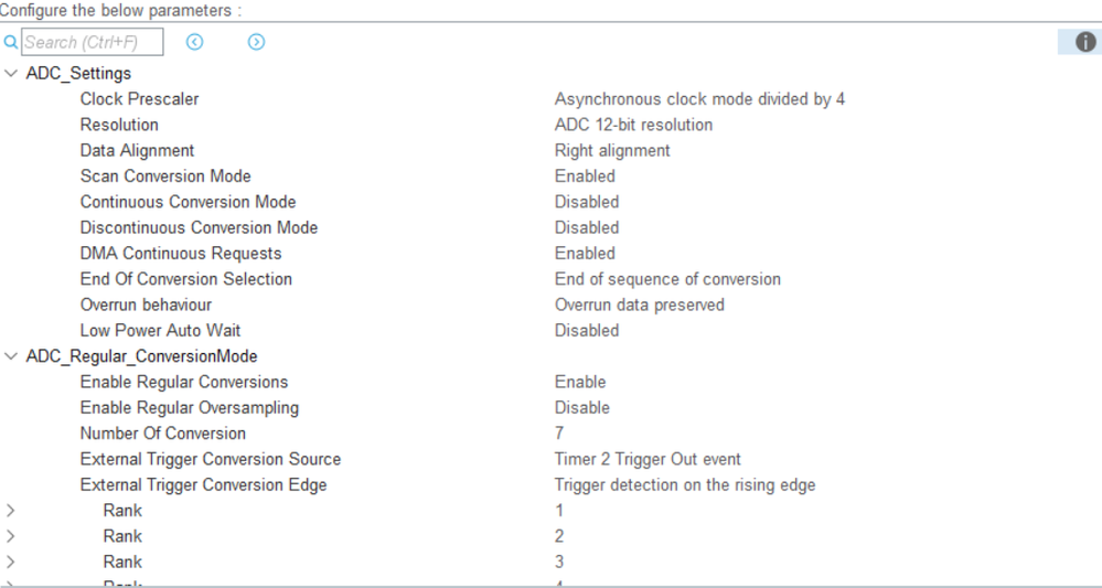

Coming from the Arduino world all of the ADC conversion stuff is new to me, so learning it as I go. There are a lot of options to choose (trigger conversion edge, sampling time, offset number, overrun behaviour, end of sequence selection, etc.) and it's hard to tell from the documentation what they do and how they all work together. This all works so I'm really curious if someone with more experience has any ideas on if it could be better, more efficient, etc.
Here is my ADC setup
There isn't a lot of custom code, most is IDE generated HAL stuff, so below are the relevant sections
