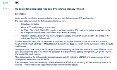

Please refer to the STM32H5 errata sheet, in the limitation related to "I3C controller: unexpected read data bytes during a legacy I2C read".
2024-12-03 7:13 AM
Hello Imen.D,
I could not find the clue from the errata.
