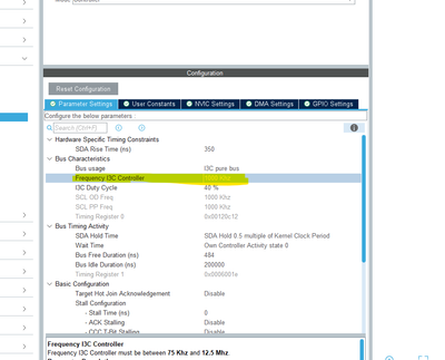

Hello @GH502
To reduce the operating frequency, configure the I3C controller to 1 MHz using STM32CubeMX.
2025-11-07 12:44 AM
Hi Saket_Om,
If I change the I3C frequency to 1MHz, My I3C device could only work at 1MHz, but I want it to work faster at 5MHz. Is it possible?
Thank you very much.
