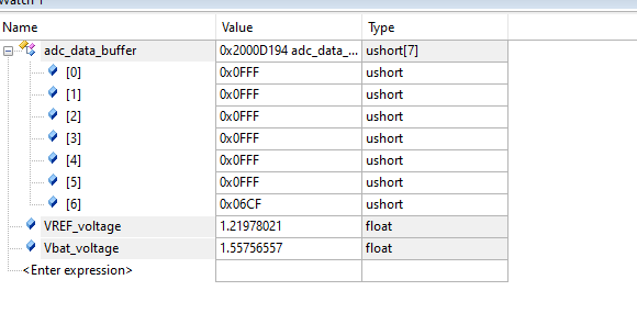

2025-09-02 8:08 PM - edited 2025-09-02 8:12 PM
Hi JW
*VREFINT_ADDR value is 0x0681,
But there's a really weird thing: when I connect the VBAT pin on the NUECLEOL476 development board to the 3.3V on the board, all of the adc registers value is 0x0000,I don't konw why

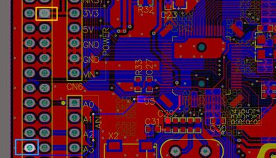

2025-09-03 1:31 AM
Isn't VBAT connected to some other circuitry on that board? (I haven't checked).

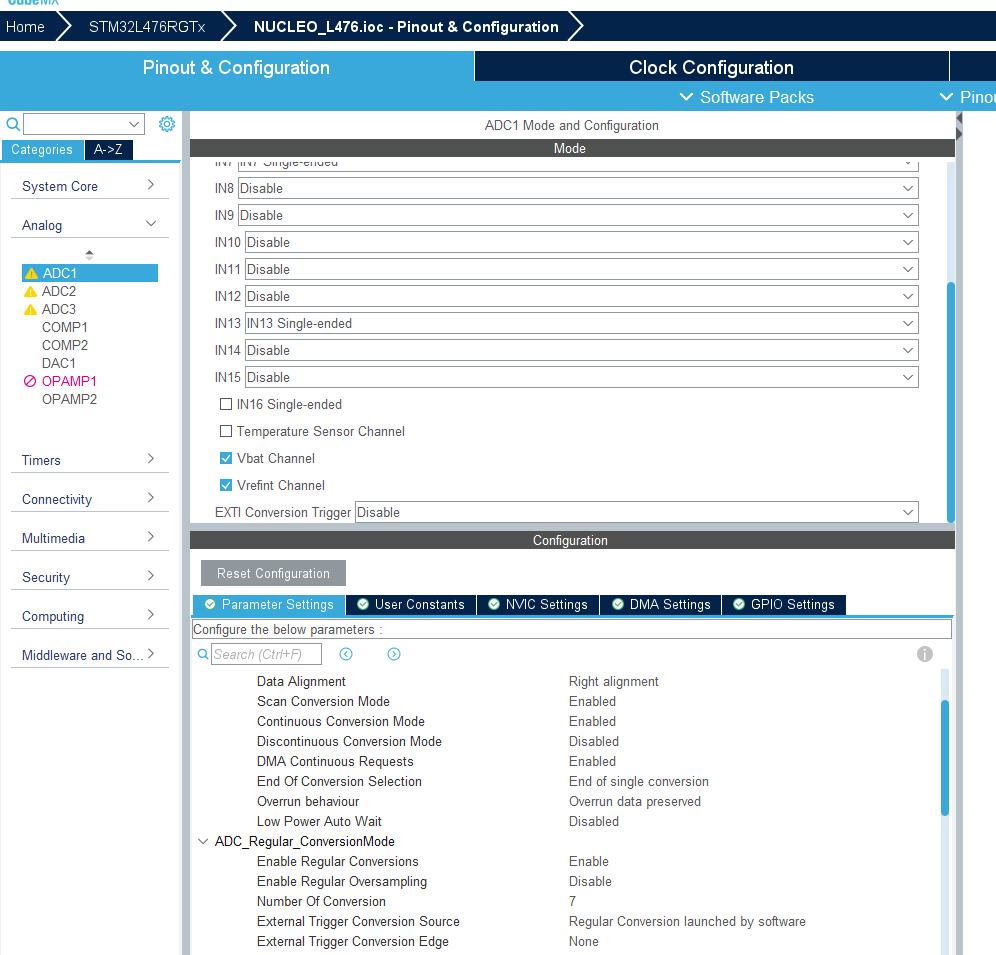

2025-09-03 2:16 AM - edited 2025-09-03 3:09 AM
yeah,I connect VBAT with the Onboard 3.3V,and following is mine ADC config
eson

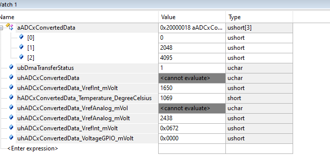

2025-09-03 6:42 PM - edited 2025-09-03 7:00 PM
Hello Saket_Om
Thanks for your suggestion,When I tried to use the program under Projects\NUCLEO-L496ZG\Examples\ADC\ADC_Sequencer, it got stuck in the HAL_Init() function. However, I carried out debugging using the program under Projects\NUCLEO-L476RG\Examples_LL\ADC\ADC_MultiChannelSingleConversion.
I have obtained the following data:
These data seem to have some issues.
I noticed that the VBAT and VDD on my board are connected together and I'm not sure if this affects the VBAT acquisition data.
eson
