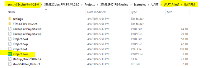

Example Project:
The example project is called UART_Printf. Here is a screen shot of the directory
This example code can be found here: https://www.st.com/en/embedded-software/stm32cubef4.html

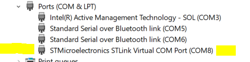

I want printf() to send data out USART2. And if it did, think I would also see the data on the Virtual USB Com Port too. In device manager I do get this:
So that is a good sign.

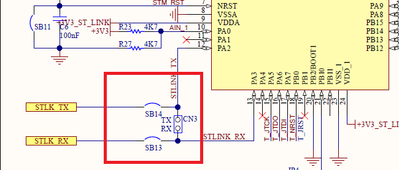

From the code snippet you shared, it desn't seem to be the native example provided in this path: Projects\STM32F401RE-Nucleo\Examples\UART\UART_Printf
I can see:
/* USER CODE END 3 */
Which concludes you're using CubeMx and you did some modifications by inspiring from the example.
Start by compiling the native example and program your target board with it to ensure the HW is fine.
What about the pins you have configured for USART2: are they PA2 (Tx) and PA3 (Rx)?
Check your HW:
CN3 jumper should be off.
SB13 should be soldered.

2024-04-05 12:59 PM
I can see:
Check your HW:
