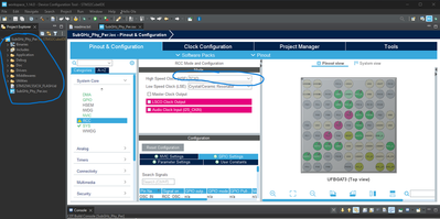

See image below
In the project explorer pane highlighted in blue you can see the default data structure that STM32CubeMX generated when the Example Selector option was used by default.

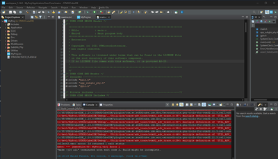

The only issue now is that, any subsequent changes to the configuration file after renaming the project breaks the project. For example using the image above if I change the RCC configuration highlighted in blue, meaning change High Speed Clock(HSE) option from TCXO to Disable and immediately back to TXCO and save the configuration. After the project is regenerated then I get the following.
In the Project Explorer two additional folders are added to the top level tree structure namely Core and SubGHz_Phy. There are other folders that are generated in the Middleware and the Utilities folder which is not in the initial generated project.
When I was previously trying to reproduce the problem I was not changing the project name which was why I could not reproduce the bug however when I first discovered the bug I had already changed the project name.
Below are logs showing the issue.
C://devl/MyProj/Drivers/STM32WLxx_HAL_Driver/Src/stm32wlxx_hal_pwr_ex.c:632: multiple definition of `HAL_PWREx_EnableFlashPowerDown'; ./Drivers/STM32WLxx_HAL_Driver/Src/stm32wlxx_hal_pwr_ex.o:C:/devl/MyProj/STM32CubeIDE/Debug/../Drivers/STM32WLxx_HAL_Driver/Src/stm32wlxx_hal_pwr_ex.c:632: first defined here C:/ST/STM32CubeIDE_1.14.0/STM32CubeIDE/plugins/com.st.stm32cube.ide.mcu.externaltools.gnu-tools-for-stm32.11.3.rel1.win32_1.1.100.202309141235/tools/bin/../lib/gcc/arm-none-eabi/11.3.1/../../../../arm-none-eabi/bin/ld.exe: ./Drivers/STM32WLxx_HAL_Driver/stm32wlxx_hal_pwr_ex.o: in function `HAL_PWREx_DisableFlashPowerDown': C:/ST/STM32CubeIDE_1.14.0/STM32CubeIDE/plugins/com.st.stm32cube.ide.mcu.externaltools.gnu-tools-for-stm32.11.3.rel1.win32_1.1.100.202309141235/tools/bin/../lib/gcc/arm-none-eabi/11.3.1/../../../../arm-none-eabi/bin/ld.exe: ./Utilities/timer/stm32_timer.o: in function `UTIL_TIMER_Start': C:/devl/MyProj/STM32CubeIDE/Debug/../Utilities/timer/stm32_timer.c:150: multiple definition of `UTIL_TIMER_Start'; ./Utilities/stm32_timer.o:C://devl/MyProj/Utilities/timer/stm32_timer.c:150: first defined here C:/ST/STM32CubeIDE_1.14.0/STM32CubeIDE/plugins/com.st.stm32cube.ide.mcu.externaltools.gnu-tools-for-stm32.11.3.rel1.win32_1.1.100.202309141235/tools/bin/../lib/gcc/arm-none-eabi/11.3.1/../../../../arm-none-eabi/bin/ld.exe: ./Utilities/timer/stm32_timer.o: in function `UTIL_TIMER_StartWithPeriod': C:/devl/MyProj/STM32CubeIDE/Debug/../Utilities/timer/stm32_timer.c:203: multiple definition of `UTIL_TIMER_StartWithPeriod'; ./Utilities/stm32_timer.o:C://devl/MyProj/Utilities/timer/stm32_timer.c:203: first defined here C:/ST/STM32CubeIDE_1.14.0/STM32CubeIDE/plugins/com.st.stm32cube.ide.mcu.externaltools.gnu-tools-for-stm32.11.3.rel1.win32_1.1.100.202309141235/tools/bin/../lib/gcc/arm-none-eabi/11.3.1/../../../../arm-none-eabi/bin/ld.exe: ./Utilities/timer/stm32_timer.o: in function `UTIL_TIMER_SetPeriod': C:/devl/MyProj/STM32CubeIDE/Debug/../Utilities/timer/stm32_timer.c:289: multiple definition of `UTIL_TIMER_SetPeriod'; ./Utilities/stm32_timer.o:C://devl/MyProj/Utilities/timer/stm32_timer.c:289: first defined here C:/ST/STM32CubeIDE_1.14.0/STM32CubeIDE/plugins/com.st.stm32cube.ide.mcu.externaltools.gnu-tools-for-stm32.11.3.rel1.win32_1.1.100.202309141235/tools/bin/../lib/gcc/arm-none-eabi/11.3.1/../../../../arm-none-eabi/bin/ld.exe: ./Utilities/timer/stm32_timer.o: in function `UTIL_TIMER_IRQ_Handler': C:/devl/MyProj/STM32CubeIDE/Debug/../Utilities/timer/stm32_timer.c:366: multiple definition of `UTIL_TIMER_IRQ_Handler'; ./Utilities/stm32_timer.o:C://devl/MyProj/Utilities/timer/stm32_timer.c:366: first defined here C:/ST/STM32CubeIDE_1.14.0/STM32CubeIDE/plugins/com.st.stm32cube.ide.mcu.externaltools.gnu-tools-for-stm32.11.3.rel1.win32_1.1.100.202309141235/tools/bin/../lib/gcc/arm-none-eabi/11.3.1/../../../../arm-none-eabi/bin/ld.exe: ./Utilities/trace/adv_trace/stm32_adv_trace.o: in function `UTIL_ADV_TRACE_Init': /* Code trauncated for 20000 limit * C:/devl/MyProj/STM32CubeIDE/Debug/../Utilities/trace/adv_trace/stm32_adv_trace.c:394: multiple definition of `UTIL_ADV_TRACE_COND_Send'; ./Utilities/stm32_adv_trace.o:C://devl/MyProj/Utilities/trace/adv_trace/stm32_adv_trace.c:394: first defined here C:/ST/STM32CubeIDE_1.14.0/STM32CubeIDE/plugins/com.st.stm32cube.ide.mcu.externaltools.gnu-tools-for-stm32.11.3.rel1.win32_1.1.100.202309141235/tools/bin/../lib/gcc/arm-none-eabi/11.3.1/../../../../arm-none-eabi/bin/ld.exe: ./Utilities/trace/adv_trace/stm32_adv_trace.o: in function `UTIL_ADV_TRACE_Send': C:/devl/MyProj/STM32CubeIDE/Debug/../Utilities/trace/adv_trace/stm32_adv_trace.c:449: multiple definition of `UTIL_ADV_TRACE_Send'; ./Utilities/stm32_adv_trace.o:C://devl/MyProj/Utilities/trace/adv_trace/stm32_adv_trace.c:449: first defined here C:/ST/STM32CubeIDE_1.14.0/STM32CubeIDE/plugins/com.st.stm32cube.ide.mcu.externaltools.gnu-tools-for-stm32.11.3.rel1.win32_1.1.100.202309141235/tools/bin/../lib/gcc/arm-none-eabi/11.3.1/../../../../arm-none-eabi/bin/ld.exe: ./Utilities/trace/adv_trace/stm32_adv_trace.o: in function `UTIL_ADV_TRACE_FSend': C:/devl/MyProj/STM32CubeIDE/Debug/../Utilities/trace/adv_trace/stm32_adv_trace.c:296: multiple definition of `UTIL_ADV_TRACE_FSend'; ./Utilities/stm32_adv_trace.o:C://devl/MyProj/Utilities/trace/adv_trace/stm32_adv_trace.c:296: first defined here collect2.exe: error: ld returned 1 exit status make: *** [makefile:80: MyProj.elf] Error 1 "make -j20 all" terminated with exit code 2. Build might be incomplete. 10:13:19 Build Failed. 601 errors, 0 warnings. (took 3s.174ms)

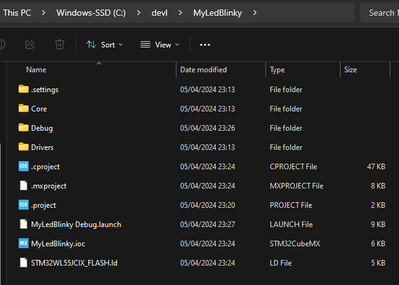

Yes I did get it to work back when I had the problem. I just found some notes that I took at the time. Following the taken notes I have just been able create a led blinky project named LEDBlinky in STM32CubeIDE and rename the project to MyLedBlinky, I also changed the .ioc file, built the project and it all seems to work fine so below are the steps that I followed.
I hope this helps.
