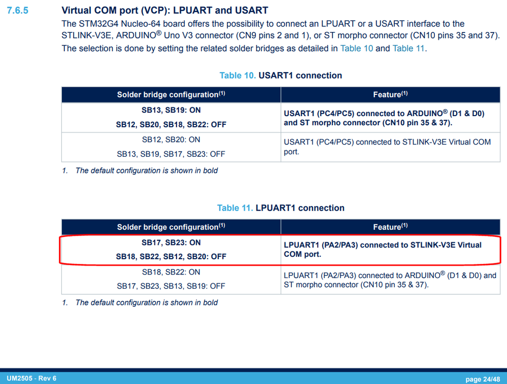

I’ve found the solution! It turns out I had mistakenly selected the wrong board/MCU part number during the initial setup in STM32CubeMX.
After restarting the project with the correct board profile and configuring LPUART1, everything is working perfectly. My apologies for the confusion, and thanks to everyone who took a look!

Before adding the complications of printf, have you got it working with a basic blocking HAL_UART_Transmit ?
Use this to prove basic connectivity.
Use ST's example specifically for the NUCLEO-G474RE.
@mpek29 wrote:the data isn't hitting the ST-Link.
How did you test that?
If it is the case, it means you are using the wrong pins for your UART - which is a common mistake.
You must use whichever pins from the STM32 are physically connected to the ST-Link's VCP pins. - other pins will not work
To find which pins those are, see the board's User Manual and/or Schematics.
@mpek29 wrote:I do this all the time with my NUCLEO-H723ZG using USART3 and it works like a charm.
Most likely, the H7 board uses different pins.
@mpek29 wrote:For the G4, I’ve switched over to USART2, but no luck.
It's the pins which really matter!
Also check that your NUCLEO-G474RE hasn't been modified to disconnect the UART from the ST-Link.

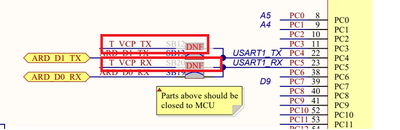

Are you aware that you can use the virtual comport over USART1 over STLINK on this board? but for that you need to solder SB12 and SB20 as they are not connected by default on the hardware.

Each board has its own hardware configuration. On NUCLEO-H723, the VCP is connected to USART3 while on NUCLEO-G474RE, VCP is connected to USART1 and you should solder SB12 and SB20 as I stated previously.

@mpek29 wrote:I've gathered that it’s possible to achieve the same functionality using UART2 instead for the NUCLEO-G474RE. .
Where did you "gather" that?
Again, the place to look is the User Manual and/or the board scheematics:
via: https://www.st.com/en/evaluation-tools/nucleo-g474re.html#documentation
