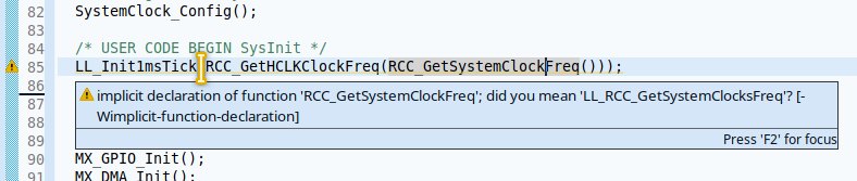

I currently use this in my main.c:
/* USER CODE BEGIN SysInit */
LL_Init1msTick(RCC_GetHCLKClockFreq(RCC_GetSystemClockFreq()));
/* USER CODE END SysInit */This seems to pass a valid HCLK to the function. But CubeIDE tells me a warning that:
../Core/Src/main.c: In function 'main':
../Core/Src/main.c:85:18: warning: implicit declaration of function 'RCC_GetHCLKClockFreq'; did you mean 'LL_RCC_GetCECClockFreq'? [-Wimplicit-function-declaration]
../Core/Src/main.c:85:39: warning: implicit declaration of function 'RCC_GetSystemClockFreq'; did you mean 'LL_RCC_GetSystemClocksFreq'? [-Wimplicit-function-declaration]
LL_RCC_GetSystemClocksFreqWhats the problem here?

The proper LL way is to call LL_RCC_GetSystemClocksFreq and use the HCLK value it returns. RCC_GetHCLKClockFreq is a private function, for whatever reason.
You could also just put the function declaration for RCC_GetHCLKClockFreq in your header and use it directly, but using a private function is probably not the proper way.

Thanks, already figured it out :)
LL_RCC_ClocksTypeDef RCC_CLOCKS;
LL_RCC_GetSystemClocksFreq(&RCC_CLOCKS);
LL_Init1msTick(RCC_CLOCKS.HCLK_Frequency);
