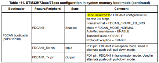

I went through the following documentation available from STM on FDCAN bootloader:
AN5405 - FDCAN protocol used in the STM32 bootloader
AN2606 - STM32 microcontroller system memory boot mode

I then re-ran everything when I remembered something from the standard/classic CAN bootloader saying that it *must* see an 0x79 frame NOT acknowledged before it'll acknowledge (put the can sniffer in listen-only mode so it would not ACK) ... no change.
It's tremendously frustrating that STMicro does not respond to any of the messages about this on the forum and their documentation is in disagreement with itself.

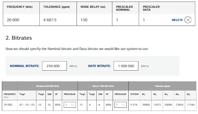

Replying to myself here.
from my other post here , the steps I took to get responses from the bootloader:
# configure the CANFD driver on Linux:
sudo ip link set can0 up type can bitrate 250000 sample-point 0.75 sjw 16 dbitrate 1000000 dsample-point 0.75 dsjw 4 fd on

It is definitely 250k/1M, and I am suspecting that the sample window/jump settings are important (I have not yet tried without them explicitly set). I am also using the flag value of 1 which should set the Bit Rate Switch flag on the outgoing CAN frame.
The bootloader seems kind of picky and can hang/crash if it's tickled the wrong way.
