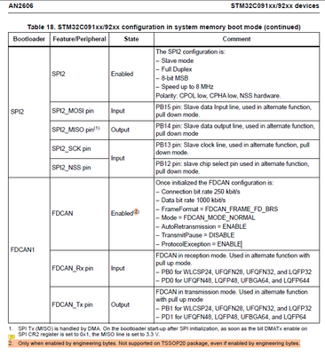

I have a STM32C092 (TSSOP20) an i was wondering if i can flash it through FDCAN, but reading the AN2606 i unfortunately found a postilla as following (page71):
Flashing through can with a TSSOP20 isn't possible, after a second look even the datasheet said the same thing.

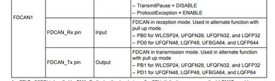

Hello @Sanderthunder and welcome to the ST community,
Indeed you need to develop your custom bootloader. And the Bootloader is not available in this package because it doesn't have the necessary FDCAN pins used for the bootloader available for this package:

2025-10-08 4:54 AM
You can use the openbl on this package. The goal of open bootloader is to give the possibility to have a customer bootloader. For information, you can configure the FDCAN pin in the interfaces_conf.h of the open bootloader project.
