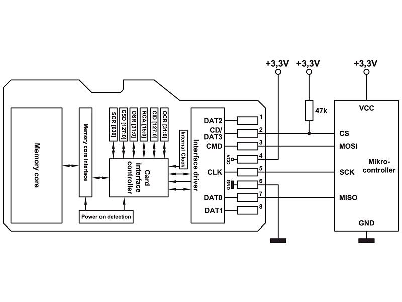

The SD card has been connected as shown below:
(CS -> NSS ?)Now I have some difficulties with controlling this card (Samsung Micro SD card 16GB SDHC).

2018-04-08 12:12 PM
The DISKIO.C layer of FATFS expects you to provide routines to read/write multiple blocks from the underlying block storage device (HD, USBSTOR/MSC, SDCard, etc). Usually the functionality for the specific interface is managed below this.
An SPI layer supporting SD, SDHC and SDXC cards can be found here
STM32Cube_FW_L4_V1.11.0\Drivers\BSP\Adafruit_Shield\stm32_adafruit_sd.c
STM32Cube_FW_L4_V1.11.0\Projects\NUCLEO-L496ZG\Demonstrations\Adafruit_LCD_1_8_SD_Joystick\Src\sd_diskio.c
There is a multi-sector bug in this code, but it is fixable. The bigger problem is the inherent slowness of such implementations.
https://community.st.com/0D50X00009XkgXzSAJ
For an 16 GB SDHC card the SD/MMC code would need to support the appropriate command set, so other web examples of this may not do that. The adafruit code should be good for cards >200GB
